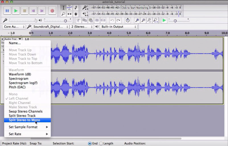

Should you be, like us, using Audacity then splitting the track to mono is very straightforward. All you need to do is select “Split Stereo to Mono” via the drop down menu arrow icon on the left hand side of your track as illustrated below:
Asterisk IVR prompt recordings with Audacity
Once the tracks have been split, you can delete your now surplus to requirements second recording track.
