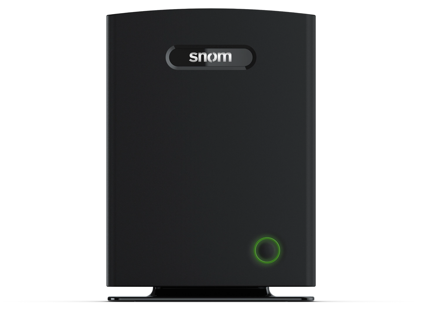

Firstly, let me apologise for my slip of the tongue, the new range can support 40 Base Stations per system, not 400 as accidentally mentioned in the video. Nevertheless, 40 base stations per installation makes for an extremely scalable system, especially when one considers that the M700 can be operated as a single cell base station and upgraded as required in the future. Talking of scalability, the M700 can support up to 200 simultaneous calls in a 40 base station system as well as 200 registered handsets within the same network. As a single cell system, the M700 can support up to 30 handsets per base station, as well as supporting the Snom M5 DECT repeater to further enhance coverage without requiring ethernet cabling.
Snom M700 DECT Base Station
Moving on to autoprovisioning, as you would expect the Snom M700 supports Snom auto-provisioning which is obviously essential when configuring and implementing larger systems. In terms of Snom autoprovisioning, the process is fairly straightforward it that once the M700 base station is connected, your IP PBX (in our case pascom) will automatically provision it and provide an IP Address where you can login to the base station Web UI and configure your phones. The default login details can be found in the product documentation, but for reference purposes both the username and password are set as admin as standard.
On top of this, the M700 also supports Over-the-air synchronisation which is essential for both seamless handovers when wandering between base station or repeater coverage areas, accross multiple floors or larger organisational spaces. Whilst we are on the subject of airways, it is also worth mentioning that the M700 has an indoor coverage radius of 50m (outdoors is upto 300m, although the system is designed for indoor use only). In addition to being suitable for indoor use, it is also worth noting that the M700 supports PoE and can be positioned either using the included foot stand or via wall or ceiling mounting.
Finally on the Snom M700, not only do you not require a DECT manager, but also Snom are not hiding any additional costs through additional licences. This provides a welcome transparency as well as providing you with cost controlling abilities whilst implementing a powerful DECT system. For the security conscious of you, you will be happy to know that the M700 ensures wireless security via DECT encryption, but Snom have also ensured secured SIP communications by implementing both TLS and SRTP security protocols.

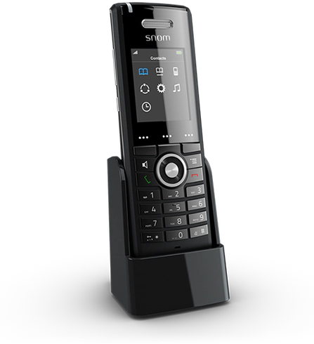

The Snom M65 is also packed with notable features and highlights. As we mentioned in our video, our technical support team have had the actual system that we demonstrated in operation for testing purposes, and one of the aspects they were most impressed with is the intuitiveness and user friendliness of the Graphical User Interface (GUI) - even if I can’t use it backwards, which is more my fault than that of the phone. Regarding the GUI, it boasts a large 2" TFT backlit display as well as a durable backlit key pad for low light conditions. Speaking of durability, the device casing has a sturdy construction with a scratch resistant matt black finish, which provides added protection as well as an elegant and sleek finish.
Snom M65 DECT Handset
Other noteworthy M65 specs include standby/talk times of 250 / 17 hours, a local & shared address book as well as the customary headset plug for increased freedom of movement.
